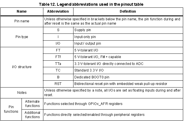

Posted on February 02, 2017 at 07:42
You should probably update your datasheet.
http://www.st.com/content/ccc/resource/technical/document/datasheet/cd/46/43/83/22/d3/40/c8/DM00090510.pdf/files/DM00090510.pdf/jcr:content/translations/en.DM00090510.pdf
Rev5 explains about TTa IO type in table 12:0690X00000605sNQAQ.png
It also specify Absolute Maximum Ratings for this type of GPIO in table 21:
as well as General operating conditions in table 24:
You will also find a lot of data in the I/O port characteristics ...

On STM32F0 devices, VDD and VDDA voltage could be different therefore TTa pins require a dedicated description. like that:
for example.(from STM32F072x8 datasheet)
