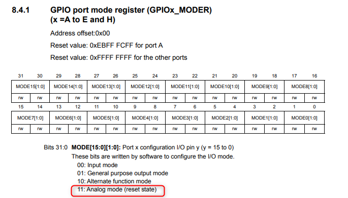

if it is already in reset mode then why have to configure in software? and why it makes a change while configuring in software as analog input then reset state by it self(without software config)?
