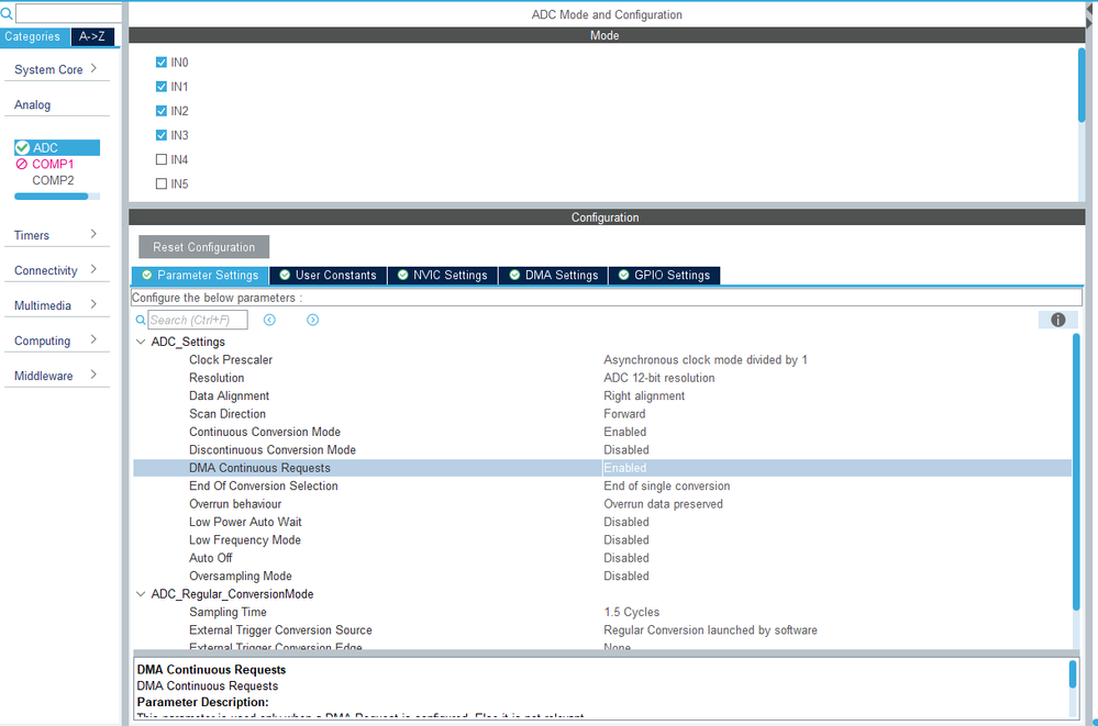

Hey. I am trying to read multiple ADC channels using DMA but with no luck. My project settings:
I have selected 4 channels and enabled Continuous conversion mode as well as DMA Continuous requests.

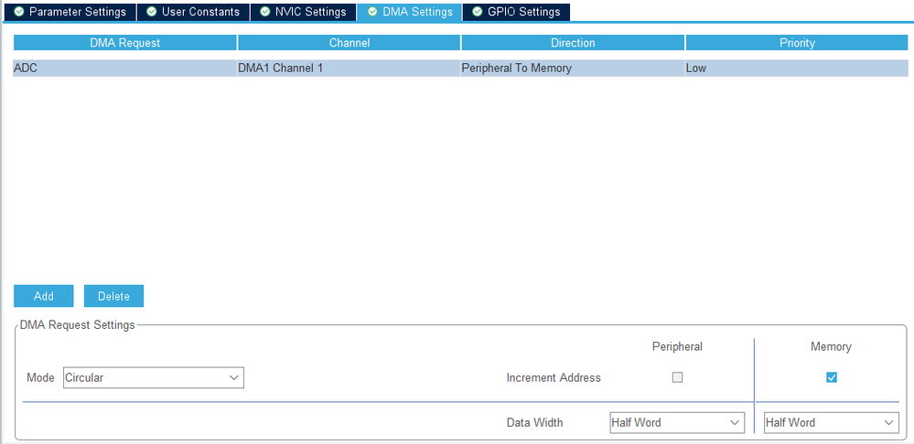

I have also created a circular DMA for ADC :

I set a breakpoint in while loop every 1 second and have added dma_buf to the expressions. Only the first element of an array is getting filled and it seems that it is a wrong value. I have about 2.9V on that pin so a reading should be about 3600 or 3500:

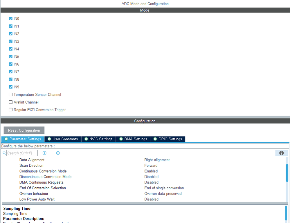

I have also attempted to try and read multiple channels using polling method instead of DMA.

}I am getting the strangest results, when ADC0 is shorted to ground(adc_value 5 changed)
adc_value 1 = 3554
adc_value 2 = 3486
adc_value 3 = 3602
adc_value 4 = 3605
adc_value 5 = 66
adc_value 6 = 3520
adc_value 7 = 3560
adc_value 8 = 3486
adc_value 9 = 3521
adc_value 10 = 3606
when ADC1 is shorted to ground, none of the values change
adc_value 1 = 3546
adc_value 2 = 3462
adc_value 3 = 3394
adc_value 4 = 3462
adc_value 5 = 3594
adc_value 6 = 3523
adc_value 7 = 3560
adc_value 8 = 3462
adc_value 9 = 3504
adc_value 10 = 66
when ADC2 is shorted to ground (adc value4 and ac value10 are changed):
adc_value 1 = 3550
adc_value 2 = 3469
adc_value 3 = 3397
adc_value 4 = 66
adc_value 5 = 3600
adc_value 6 = 3524
adc_value 7 = 3561
adc_value 8 = 3469
adc_value 9 = 3510
adc_value 10 = 66
When ADC3 is shorted to ground adc value 3 change
adc_value 1 = 3543
adc_value 2 = 3462
adc_value 3 = 66
adc_value 4 = 3610
adc_value 5 = 3604
adc_value 6 = 3528
adc_value 7 = 3564
adc_value 8 = 3461
adc_value 9 = 3291
adc_value 10 = 3612
when ADC4 is shorted to ground, adc_value 9 change:
adc_value 1 = 3533
adc_value 2 = 3200
adc_value 3 = 3602
adc_value 4 = 3609
adc_value 5 = 3605
adc_value 6 = 3524
adc_value 7 = 3557
adc_value 8 = 3200
adc_value 9 = 66
adc_value 10 = 3610
when ADC5 is shorted to ground adc value 2 and and value 8 change:
adc_value 1 = 3316
adc_value 2 = 68
adc_value 3 = 3608
adc_value 4 = 3616
adc_value 5 = 3611
adc_value 6 = 3523
adc_value 7 = 3554
adc_value 8 = 66
adc_value 9 = 3534
adc_value 10 = 3616
when ADC6 is shorted to ground, adc_value 1 is changed:
adc_value 1 = 66
adc_value 2 = 3484
adc_value 3 = 3607
adc_value 4 = 3610
adc_value 5 = 3606
adc_value 6 = 3508
adc_value 7 = 3308
adc_value 8 = 3484
adc_value 9 = 3530
adc_value 10 = 3612
and etc.... As you can see, it is messed up. Could someone help me understand why would that happen?
