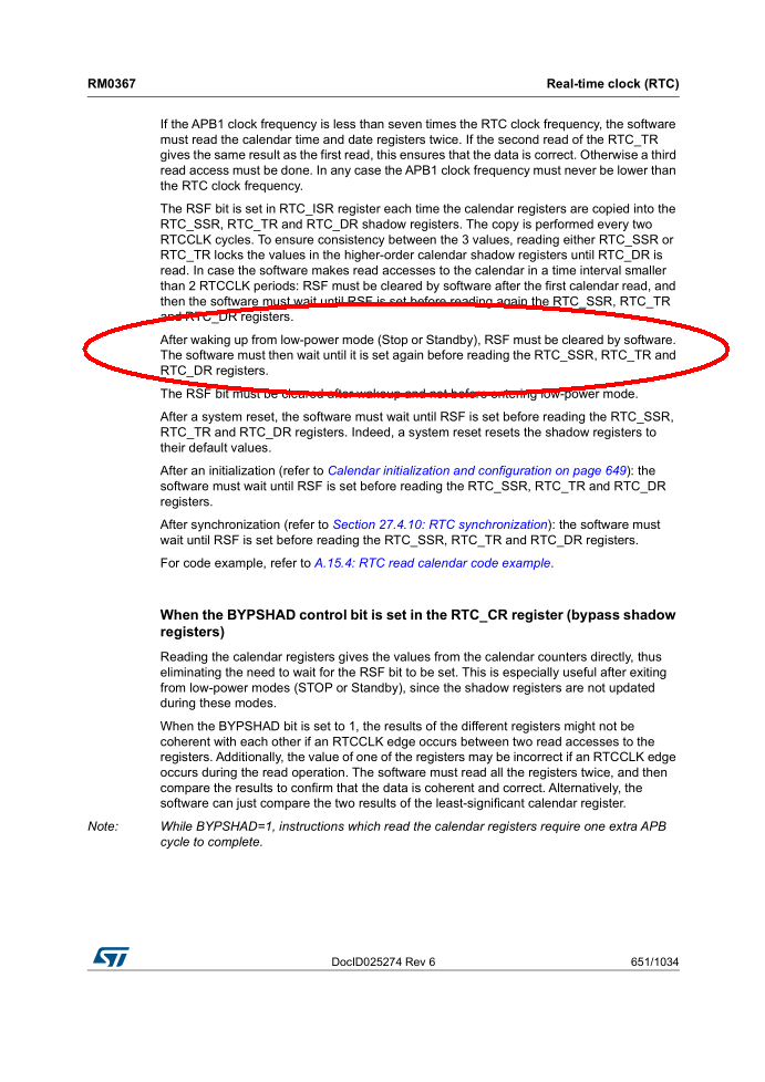

waclawek.jan
Super User
Do you follow this procedure?

waclawek.jan
Super User
Reading out the RTC *before* going to sleep, using the same method, does result in always correct time?
How exactly do you read out and check it? Post code.

FEber.1
Associate III
Hi Jan,
many thanks for the good hint.
Your suspicion was right.
The fault isn't cause during standby.
In case of reading the RTC before entering the standby mode the I found the error too.

FEber.1
Associate III
Hi Jan,
the real solution of my originally problem was your hint concerning the treatment of RTC_ISR_RSF.
The other problem was a very embarrassing mistake of mine:
I always overlooked that the RTC keeps BCD values and not binary values.
The interpretation of BCD numbers as binary numbers then led to unexpected changes of the numbers.
Sorry for this stupid mistake!
