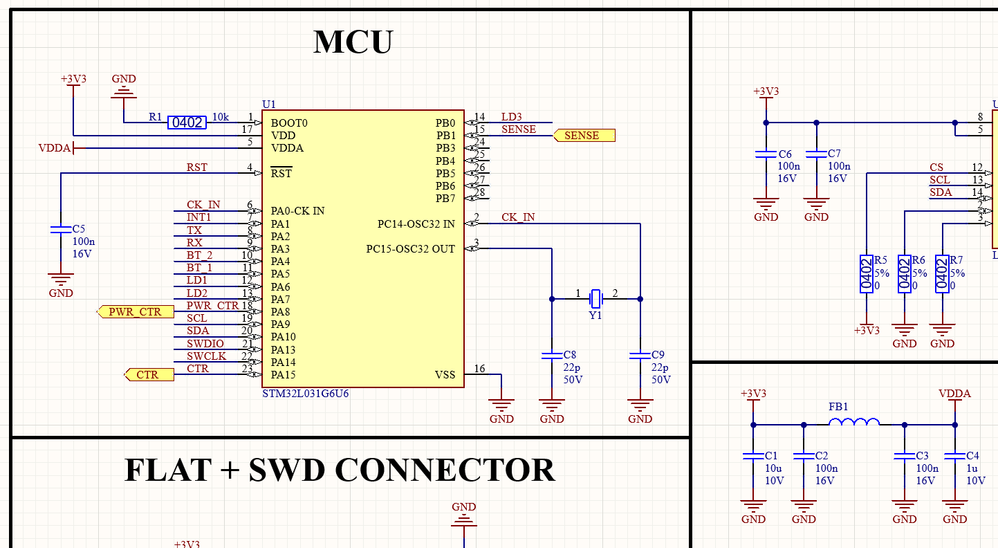

I have a problem with a STM32L031G in a custom board.
The program don't run after the program.
BOOT0 is connected to gnd via 10K resistor.
Attached you can find a circuit diagram and clock configuration.
what could be the problem?
Thanks
Michele

Schematic

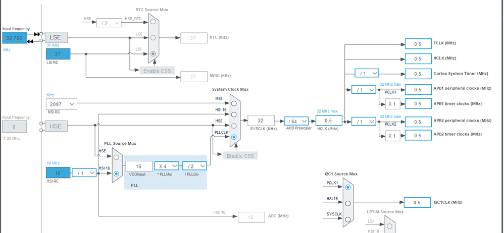

Clock Configuration

Skip SystemClock_Config() entirely, let the system continue to run at the clock it started on, and not the snail paced 500 KHz. Watch the 1KHz SysTick doesn't saturate.

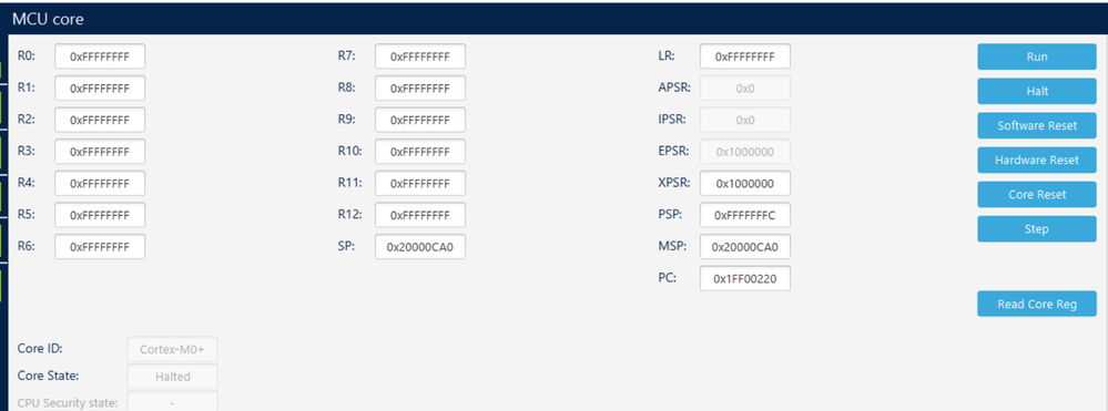

Update:
if upload the code and press "software reset" and "run" in STM32CubeProgrammer the uC execute the code without problem.
have you ever had this problem? how can i solve it?
