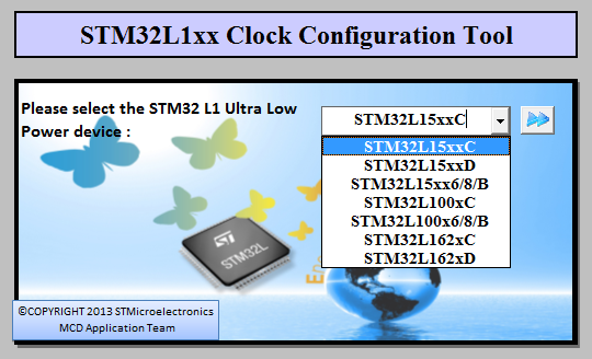

I am trying to configure the clock source in a STM32L Nucleo Board (that mounts the STM32L152RE microcontroller). I use EmBitz as IDE.
I have downloaded the Excel file STM32L1xx Clock configuration tool from ST that generates the system_stm32l1xx.c file to configure the microcontroller.However the configuration tool does not allow to select the microcontroller I use (STM32L15xxE is not present).Any idea how to create the configuration file?2016-01-11 3:15 AM

Yes, but when you start the tool (see the image below) you are asked to choose the microcontroller and there is not STM32L15xxE option.

Use C optioc. E option is only different flash size. RCC peripheral is the same. Generate file will be valid.
