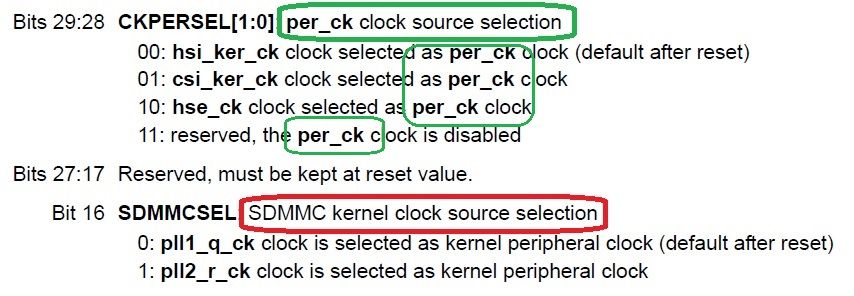

8.4.17 RCC Domain 1 Kernel .. (RCC_D1CCIPR)
SDMMCSEL: SDMMC kernel clock source selection
Need to explicitly name ''sdmmc_ker_ck'' here so it cross references with all other uses, like per_ck is in CKPERSEL[1:0], and is searchable/indexed
This is just one example, but is a systemic issue in the document and all other places refer to clocks, etc by their internal net names.
