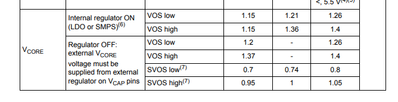

This kind of information can be found in the datasheet but seems only two voltage levels are available (low and high)

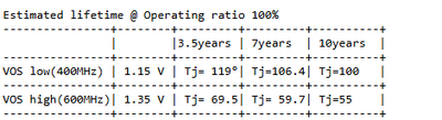

The estimation of the current profile is given in the Table below.

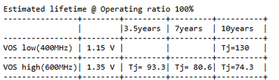

The target for the industrial mission profile is given below also.
Estimated lifetime @ Operating ratio 100%
Hope that helps.

Hello @mƎALLEm ,
thank you for that helpful information!
What exactly is the difference between the first and the second table? What does "industrial mission profile" mean?
Our guess is that the first table is for STM32H7S7L8H6 and the second "industrial mission profile" table is for STM32H7S7L8H6H?
But we could not find that information on the product page or datasheet. Can you tell us where to find the differences between STM32H7S7L8H6  and STM32H7S7L8H6H?

@mƎALLEm but the first table says
10 years with VOS high and Tj=55°C
10 years with VOS high and Tj=74.3°C
what is the difference between the two tables if it is not the grade of the chip? How is "industrial mission profile" defined in that context?
