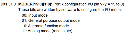

Hello @Jacob L ,
it is possible that the PB8 pin is configured as an alternate function other than GPIO, to check that, try reading the GPIOx_MODER register :

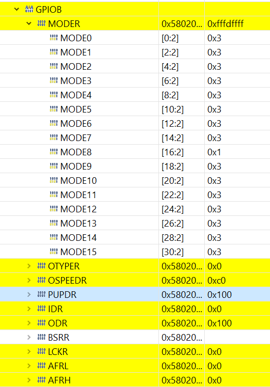

2023-01-19 6:53 PM
That seems to be set correctly. Any other suggestions? Does ST have a test board with an STM32H7B3NIH chip you could try?
