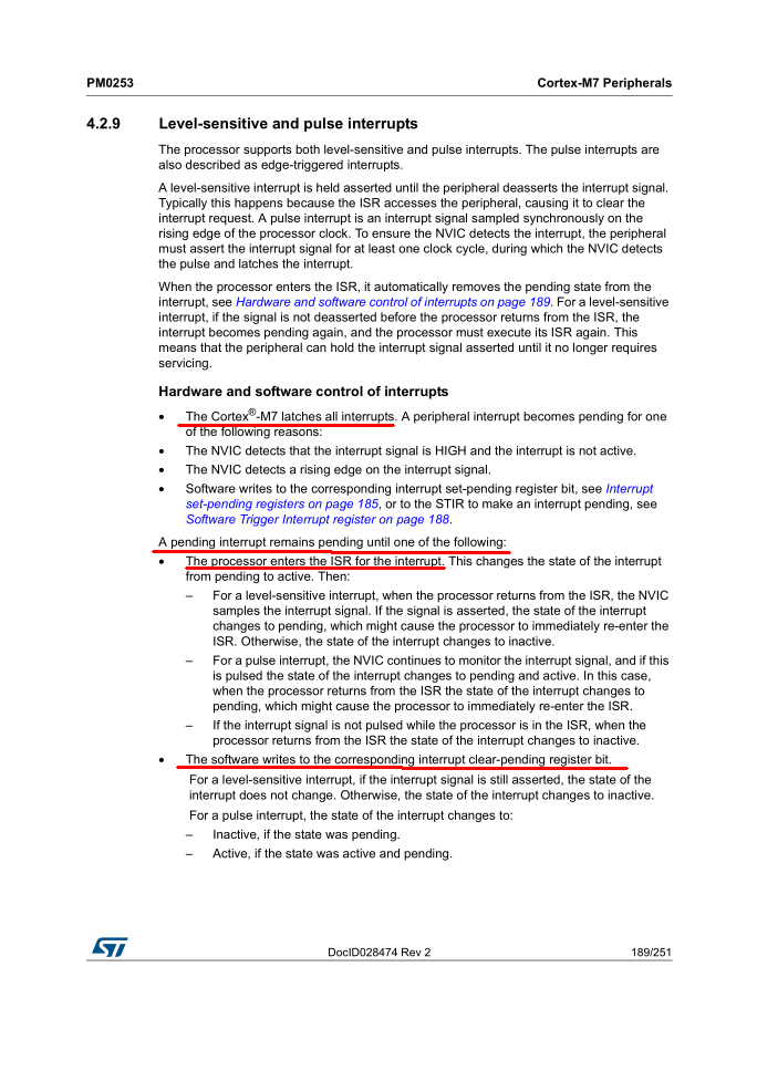

2022-03-19 3:59 AM
> clearAll_EXTI9_5_IRQ();
> HAL_NVIC_EnableIRQ(EXTI9_5_IRQn);
If there were pending interrupts in EXTI before you called clearAll_EXTI9_5_IRQ(), there may be an interrupt thrown immediately after the enable. Reason is, that it takes time until changes in EXTI pending register propagate to NVIC.
Unfortunately, there is probably no universally good solution. I tried to tackle this on an 'F4, clearing first the interrupt source (here EXTI, I experimented with TIM, but there is no difference in this regard) then interrupt pending in NVIC, but I found out that due to the undocumented internal timing if I did this quickly enough, the interrupt in EXTI "reappeared" after a few cycles. You may need to perform a similar experiment for your 'H7 (which is inifinitely more complex than 'F4) and ascertain, what influences might make one particular such assesment void (e.g. changing APB divider).

Test by clearing the PR bit at the very end of tge interrupt.
2022-03-20 1:59 AM
Outside the ISR, you have to clear also the NVIC pending bit, as I did in the post linked above.

> I assumed that the code in the HAL GPIO External interrupt handler was sufficient to clear ALL of the necessary register bits
It is, but only if you are executing the ISR. But from non-interrupt context, you have to explicitly clear also the NVIC pending bit (see NVIC_ICPRx register). This is what I quoted above: if the interrupt kicks in, it clears this bit in hardware; but if it's not the interrupt context, you have to do it yourself.

For an interrupt from say a DMA controller when a transmission is complete or there is an exception (error) the interrupt is raised in the NVIC and when the interrupt gets serviced the interrupt handler sorts out which interrupts were triggered at the peripheral level, executes handler functions if defined, then clears the peripheral interrupts. When the interrupt request function is returned by some magic the NVIC pending/active reg's clear and no more interrupts until the peripheral says so.
The multi-input interrupts on return however do NOT appear clear the interrupts in the NVIC reg's. So that on returning from the interrupt you get some more unsolicited interrupts.
What you seem to have to do is check all the multi-input interrupt flags and then after doing your stuff, execute a
NVIC_ClearPendingIRQ(EXTI9_5_IRQn)
statement.
