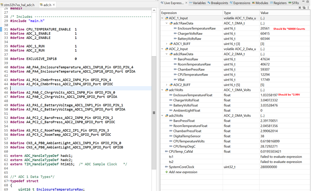

The problem I have is that ADC 1 Input 18 (PA4) reads incorrectly when the ADC2 Input 18 (Temperature sensor) is enabled.

With a temperature of 25 deg c there should be about 2.9 Volt however it is pulled down to 1.45 V. If the external circuit is removed and the PA4 pin is measured with a 10Mohm probe it floats at about 940 mV compared with the other Arduino Inputs which float at about 30 mV.
Solder bridge SB44 has been removed (STMOD-Pin13) and there is no camera connected.
When the ADC2 INP 18 Temp Sensor is left out of the mix, pin PA4 behaves as the other analogs, with a voltage of about 30 mV when floating and about 2.9 Volts with the temperature sensor circuit connected and with a sensor temperature of about 25 deg C.
Calculating the temperature with the Temp Sensor disabled gave 25.25 degrees which was spot on with a good thermometer.

I purchased another couple of the STM32H7B3I-DK Disco boards and wrote a test program to try various input combinations t get to see if the problem was due to a damaged board. It turns out it was not. The same behaviour is exhibited by both of the new boards.
I have attached my test program and a spread sheet of the results to this post.
TEST RESULTS
ADC Setup:
SystemCoreClock    280
ADC Clock PLL2P    200
hadc1.Init.ClockPrescaler    ADC_CLOCK_ASYNC_DIV8
Sample Clock Tim15    0.025
sConfig.SamplingTime    ADC_SAMPLETIME_810CYCLES_5 (ALL Inputs)
Essentially the issue only occurs when scanning more than one input on ADC1 (In addition to ADC1 IP18) and only occurs if ADC 2 is initialised to read the INP18 Temp sensor input. Whether ADC 2 is started or not makes no difference. The incorrect reading occurs in both cases.
