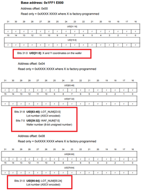

Following are what we can provide as UID structure information:
0x8FFF800 - 16 bits -> X coordinate (integer) 0x8FFF802 - 16 bits -> Y coordinate (integer)
0x8FFF804 - 8 bits -> Wafer number (integer) 0x8FFF805 - 8 bits -> LOT_ID0 (ascii code) 0x8FFF806 - 8 bits -> LOT_ID1 (ascii code) 0x8FFF807 - 8 bits -> LOT_ID2 (ascii code) 0x8FFF808 - 8 bits -> LOT_ID3 (ascii code) 0x8FFF809 - 8 bits -> LOT_ID4 (ascii code) 0x8FFF80A - 8 bits -> LOT_ID5 (ascii code) 0x8FFF80B - 8 bits -> LOT_ID6 (ascii code)
It's the same as STM32H743.
I'm pushing internally to add these details in RM0455.

No. RM0433 shows wafer and lot information. Please check again.
PS: we cannot provide more details than what was provided in RM0433

Hello @RCooke88 ,
