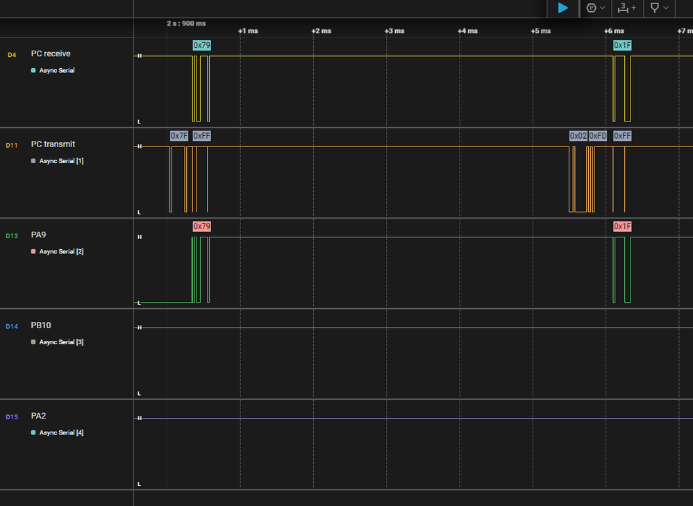

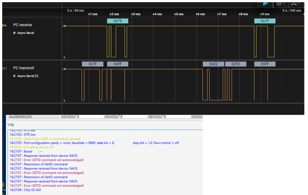

We are having difficulty programming STM32H7 via serial ports PB14-PB15 as USART1. We are setup as described in AN2606, section 56.1 and we're using STM32CubeProgrammer for downloads. The connection is established, but the first bootloader command (get ID) is nack'ed (picture below).
connect, then fail "get-id"
This same procedure works perfectly using PA9-PA10 (also an2606, 56.1). PB14-PB15 fails.

Two updates:
First, both PB14 (expected pin) and PA9 respond with nacks:
picture 2
Second, the comment above about the uC being sensitive to baud rate was incorrect, ... the Saleae capture is sensitive to baud rate. The picture above is 38400 and connected (then failed with a nack) just fine. :)
