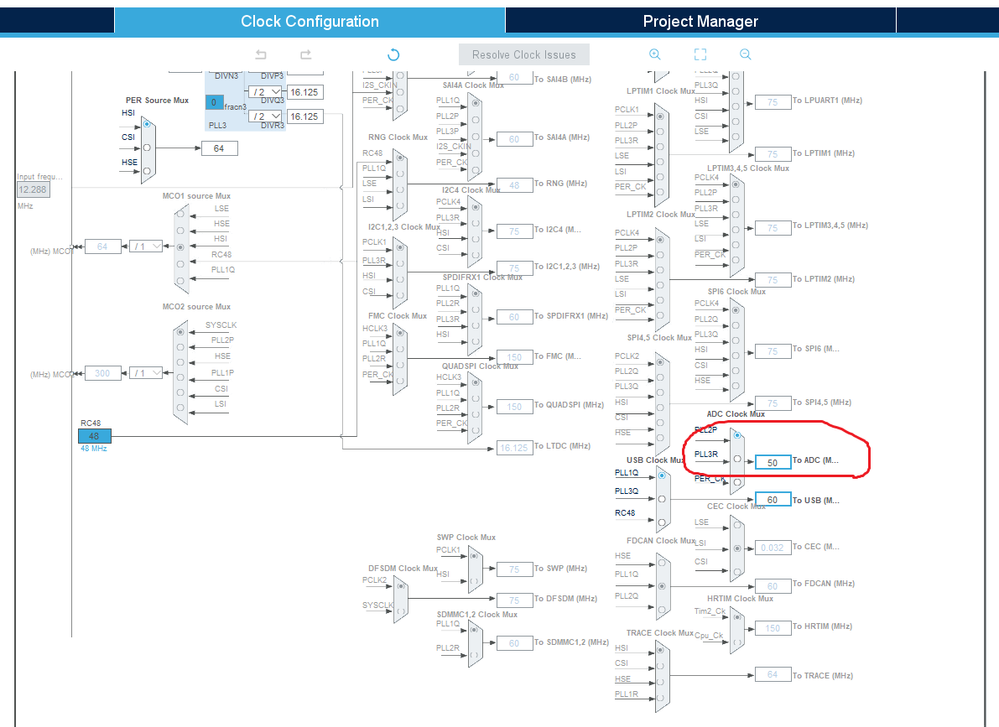

*The clock uses 50MHz of PLL2.

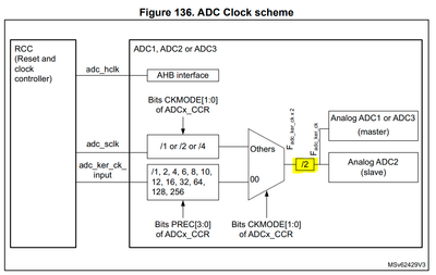

Take a look at the reference manual at the 25.4.3 ADC clocks section to see how the ADC clock is derived. This is the clock figure for the V revision. The Y revision does not have this divisor.

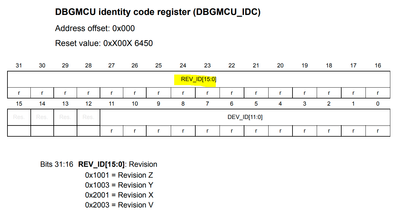

To find out what hardware revision you have, you can read the REV_ID field from the device.
You can read this field with the HAL_GetREVID() function and adjust your ADC prescaler accordingly.

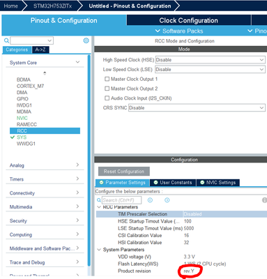

CubeMX also has a setting you're supposed to set based on the revision. Not sure how this plays into code generation.

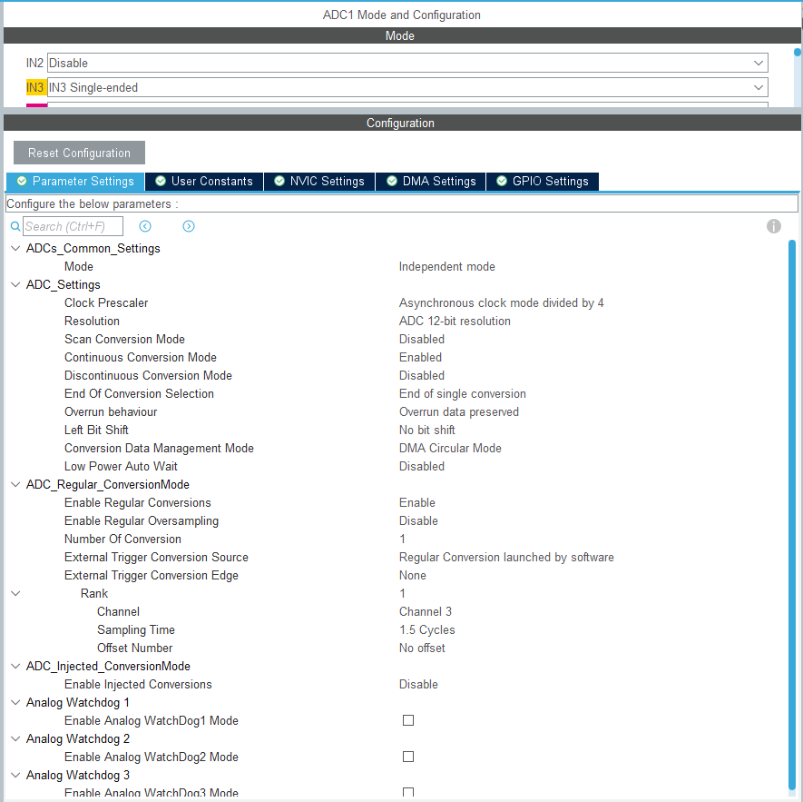

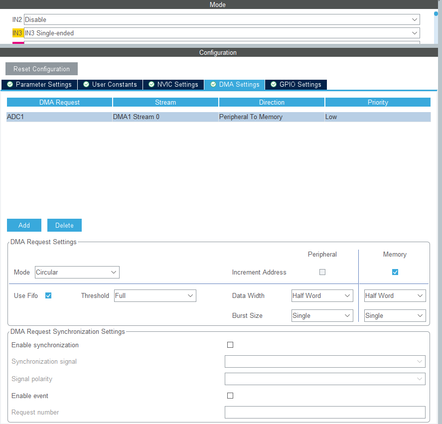

The settings are done according to the attached contents.

I don't think this math checks out. 50e6/4/8 = 1.5625 Msps
Note that revision V devices have an additional /2 ADC clock scaling.

I'd like to know more about this, but what does it mean that Revision V devices have an additional /2 ADC clock scaling? On the Cube MX's Clock Configuration screen, it is 50MHz, but will the frequency be further divided from here?
