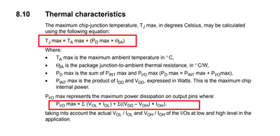

Hi @Manikandan,
For your first question, the term Tj refers to the junction temperature, which is the maximum internal temperature that the core of the microcontroller can reach during operation. It is calculated as follows:
TJ max = TA max + (PD max × ΘJA)
For your third question, power dissipation is the amount of electrical energy converted into heat. This dissipation is important because it affects the internal temperature and is calculated as follows:
PI/O max = Σ (VOL × IOL) + Σ((VDD – VOH) × IOH)
You can refer to the STM32H753 Datasheet, specifically section 8.10 "Thermal Characteristics," where these formulas are well explained:
