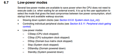

What are the different power saving mode for STM32H753 with there current consumption. What are the active functions in each mode?
2025-03-25 5:59 AM - edited 2025-03-25 6:36 AM
The information is available in the RM0433 / 6.7 Low-power modes
The power consumption is provided in the product datasheet/ section 7.3.6 Supply current characteristics starting from the table 128.
See also this presentation.
