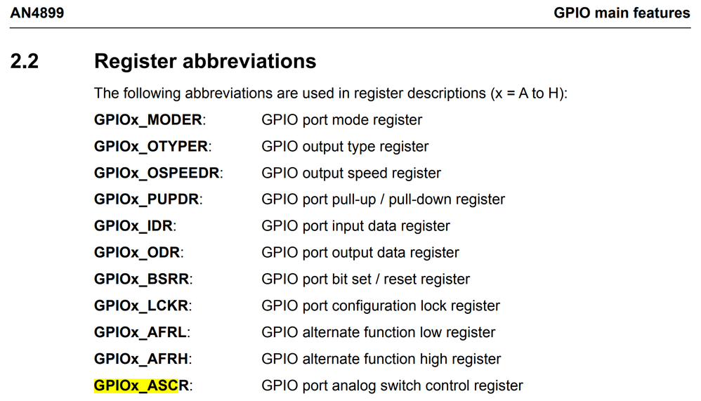

Hi @F.Belaid​ ,
I read the AN4899 (rev3 mar 2022), and it mentions the register GPIOx_ASCR in multiple places.
What is this register? I cant found it in RM of F1, F4, G4, H7.
It is not mentioned in the section 2.2 Register abbreviations.

First, GPIOx_ASCR register is specific to some series. For example, you can find it in L4 Reference Manual section 8.5.12. This register is used to configure the analog connection of the IOs to the ADC input.
Second, AN4899 note is applicable to all ST MCUs.

waclawek.jan
Super User
AFAIK, GPIOx_ASCR is only in the 'L47x/'L48x. so not even in all 'L4.
Nikita91
Lead II
Thanks, I learned something.
In fact, this concerns more the use of analog devices than the configuration of GPIO, and this may be why the application note does not talk about it much.
