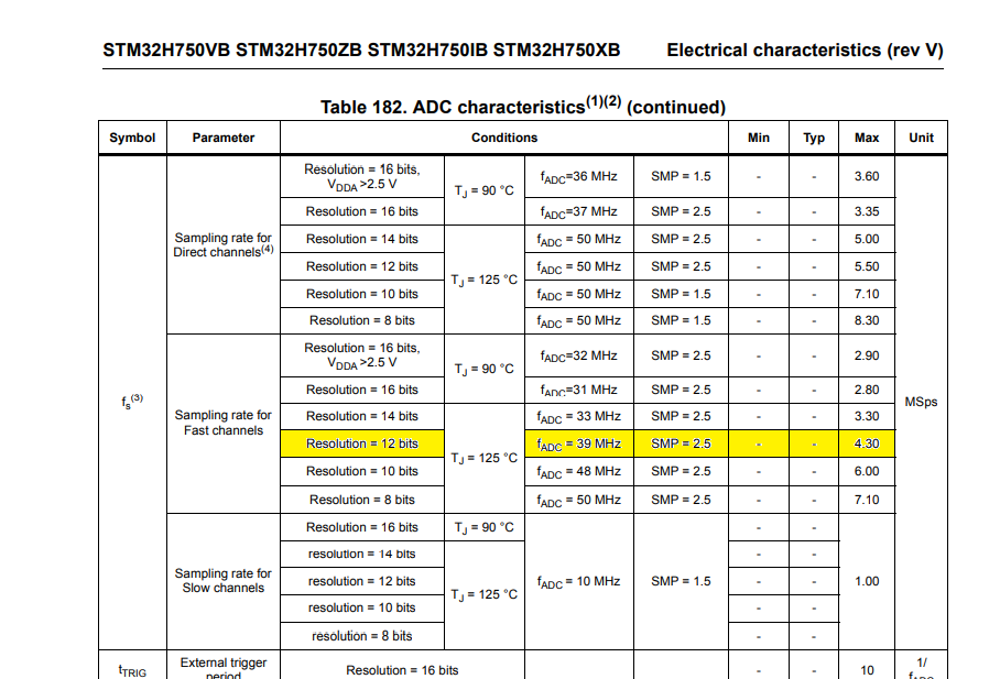

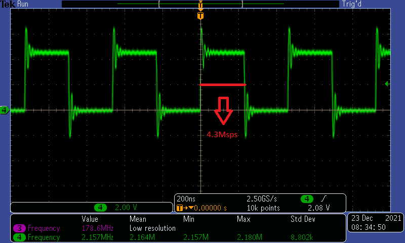

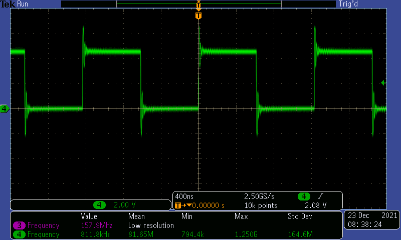

ı use stm32h750vb , I'm trying to get the adc values in the datasheet.Is the adc operated in continuous mode or in single mode when sampling rates are found.If I run it in continuous mode, I can access the values in the datasheet. But this doesn't seem to be available in single mode.I leave related images below
