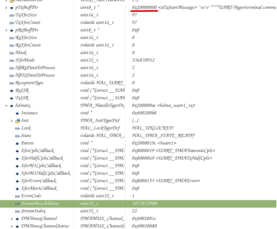

Hi nanotronicsnss ,
Here underlined the TX buff address..
Are you enabled the UART interrupt? and one more thing 1st use Normal mode instead of Circular mode in DMA config it will helpful to understand to you.
Change the TX buffer address using linker script .. see the example 2 in below mentioned link.. You can use any one method to solve your pblm..
https://community.st.com/s/article/FAQ-DMA-is-not-working-on-STM32H7-devices
refer this page. It will helpful to solve your issue..

Hi Vel,
Thanks for ur answer..i have changed the DMA address and have obtained DMA transmit
