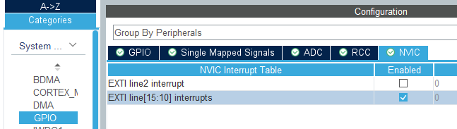

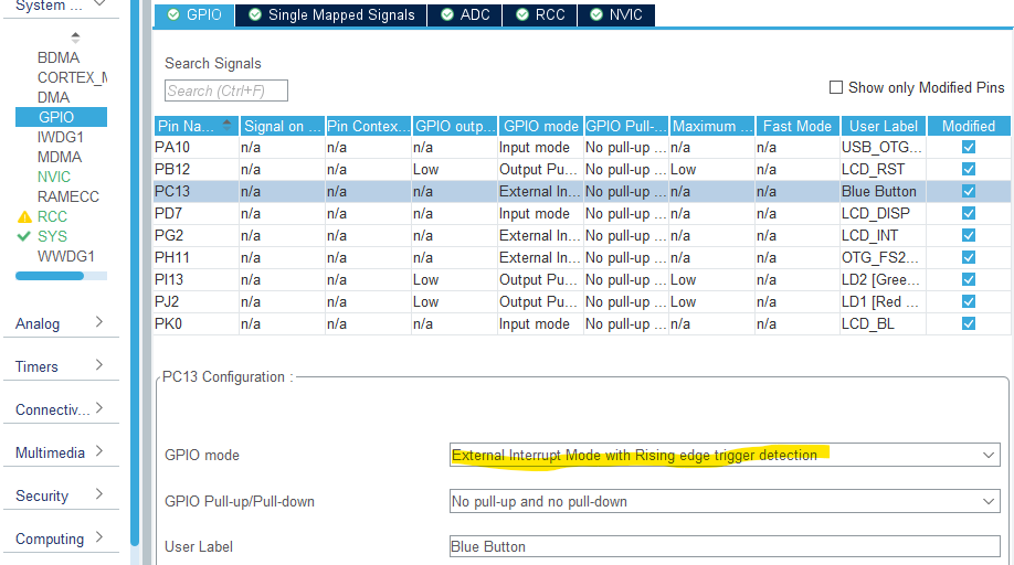

After looking at your IOC file you'll never get an interrupt on the blue button.
For the blue button to interrupt when pressed, you need to set it as a GPIO_EXTI13, not GPIO_Input.
You'll need to select a GPIO mode which i usually select both edge detection.
Then you need to enable EXTI
