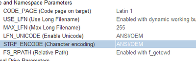

2025-01-25 12:48 PM
I think I've found the problem. I've turn to ANSI/OEM now. Everything works :D
2025-01-25 12:48 PM
