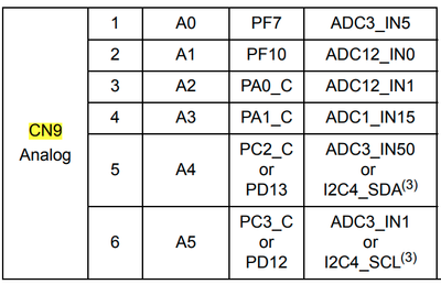

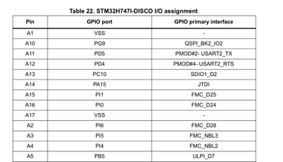

so far i only see A0 always on and A1-A5 always off. On the same pin there are two names (from gpio port and mcu pin), for example A2 can be PA0 or PI6, but try both that don't work, I've also tried mcu pin with pinnbr either. A0 always on and the rest always off, no I know which part is wrong (PLL or System Clock Configuration? this part also changes sometimes either) , I have attached the example main.c  if anywhere has a problem.

PI4 is connected to memory and doesn't appear in CN9, so why are you changing it?

Arduino pin numbering has nothing to do with STM32 pin numbers. According to the schematic A0 on CN9 is connected to PA4, but the UM2411 user manual shows PF7. I would guess the user manual is wrong. The author can test it easily...
@KDJEM.1 , this is a documentation error.

Because the same pin hay differente name in mcu pin and gpio port,like A2 as PA0_C and PI6 , the problem is those pines A1-A5 in the two name always off(i have try 6 pin ,12 name), A0 always on.

"A4" and "PA4" mean different things. The latter is a pin on the microcontroller. Pin A4 on the board isn't connected to pin PA4 on the microcontroller, as the table suggests. Read the user manual. Consult the schematic. Note the inconsistency as @Piranha described.

''Consult the schematic" which page it is in user manual?
Hello @Piranha ,
Thank you for bringing this issue to our attention.
I will check internally.
Internal ticket number: 158369 (This is an internal tracking number and is not accessible or usable by customers).
Thank you.
Kaouthar
KDJEM.1
The issue is solved in UM2411 Rev 6.
