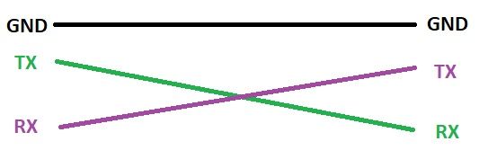

Get a scope on the signals, you CAN'T connect two transmit pins together and expect it to work.
The OUTPUT of one board needs to got to the INPUT of the second board. Both these boards have similar wiring due to them taking shields.

I have change the pin before but not work, does anyother reason could be?
It shouldn't be this hard to walk through the SW and HW and get a scope on the signals, confirming the presence of the signal, the bit rate.
Perhaps you can do a simple loop-back test at each end, seeing that transmit and receive work. Send 'U' characters, continuously, scope the signal

If you wired TWO OUTPUTs together, you might have damage one or both of the pins.
The next question will surely be if a ground needs to be connected for the loopback to work...  :rolling_on_the_floor_laughing:
We've all asked these questions at some point :grinning_face_with_sweat:
if D1 only have noise no have 0/5v/3.3v which part should be wrong?
