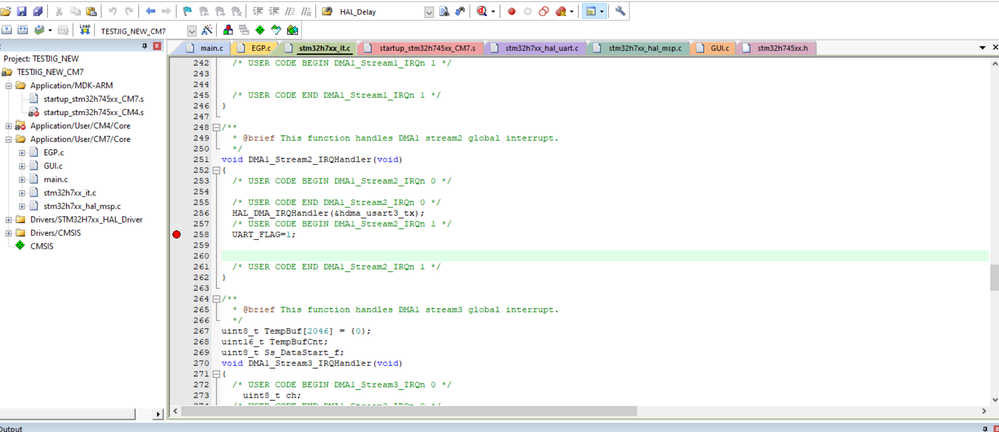

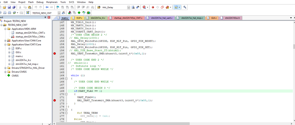

you can see my code in below attachment.

You can't cast a character to a pointer like that.
