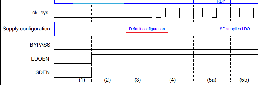

2- The MCU boots up from the default configuration and power configuration will switch to what user defined in his software in PWR_CR3 register.
If you refer to RM0399 rev 3 / "7.4.1 System supply startup" you find the different power configurations start-up:
The different steps are described at the beginning of the section 7.4.1.
Each figure shows the "Default configuration" phase and the switch to the user power config phase..
