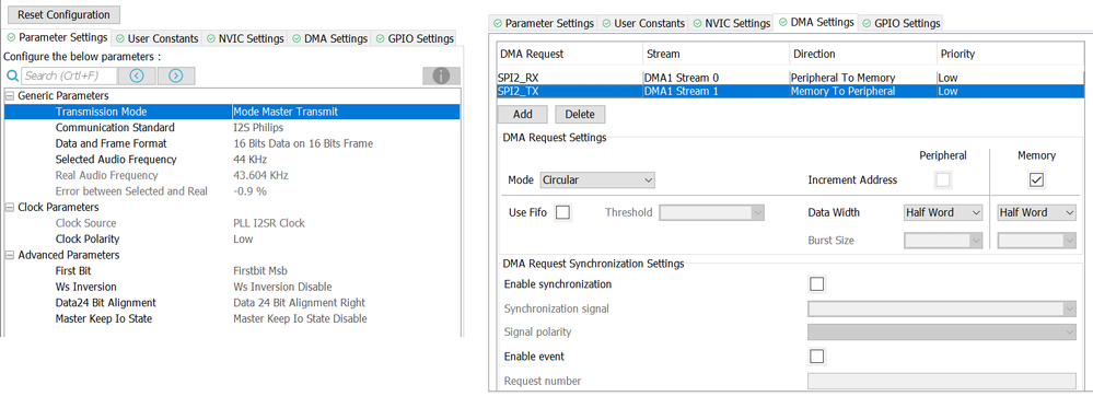

I’m having a very hard time to get the I2S communication between a STM32H745IIT and a CS4272 audio ADC/DAC running. The STM is the I2S master, the CS4272 is the slave.
What I am trying in the first place, is to send data via I2S, while reading out the I2S clock lines as well as the data line with a logic analyser. So the routing or functionality of my CS4272 doesn’t matter at first. Next to that, for now I don’t care about receiving I2S because then I have to consider hardware again….
It also tested ADC DMA without any success…

Behaviour in Hardware (via logic analyser)
While in blocking mode all (I2S) clocks are running and transmission is working, in full duplex mode with DMA the signals LRCK, SCLK and Din are dead, on the MCLK pin there is a 5.3 MHz clock signal from the STM32.

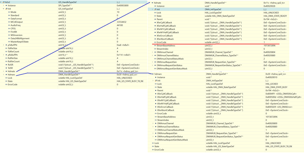

Behaviour in Software (via debug)
- No Error, Full or Half callback will be executed, the main loop is working.
- I2S2-Typedef says HAL_Unlocked, HAL_I2S_STATE_BUSY_TX_RX, Errorcode = 0
- Hdmarx says HAL_locked, HAL_DMA_STATE_BUSY, Errorcode = 0
- Hdmatx says HAL_Unlocked, HAL_DMA_STATE_READY, Errorcode = 1 (DMA transmit error)
