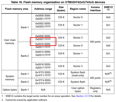

I am currently working on a bootloader with a STM32H743VGT6.
I need to write data on both banks which aren't continuous as you can see below:
It was recommended in this topic to use HEX format, but I need to stick to bin files.
So my question is:
Can I set all the data in the bin file from 0x0808 0000 to 0x080F FFFF to the value 0xFF?
Or do I need to find an other solution? Like using two bin files (which I'd like to avoid).
Thank you in advance for your help.
Best regards,
Sulian

@SMarie This picture is for STM32H742 or other models with a hole between banks. Your STM32H743 does not have a hole. Bank 2 begins immediately after bank1, so no problem.

Well that's the tricky part that I don't understand. The documentation does specify that it is a 1MB of two 512KB bank with a 512KB gap between them.

@Pavel A. wrote:@SMarie This picture is for STM32H742 or other models with a hole between banks. Your STM32H743 does not have a hole. Bank 2 begins immediately after bank1, so no problem.
It does look like it because we where putting data in this gap and it didn't get loose.
Nevertheless, the picture does include STM32H743xG models which I am using and it corresponds with the STM32H743ZGTX_FLASH.ld file:

Hmm, your STM32H743 belongs to the "xG" type. It still can have 8 sectors per bank instead of 4. But sectors 4-7 are not factory-tested and may be defective (excluded from warranty). You can test these sectors by yourself. If they appear good... use them on your own risk.
As for how to deal with the hole - it is quite large, so either make two binaries or use .hex or other format that contains the addresses.

to explain it : the die is (until now) the same, with 2 MB flash.
BUT what you buy with STM32H743xG is : 1MB (in 2 x 512K banks) is tested and guaranteed to work.
With STM32H743xI you pay more for tested 2MB (in 2 x 1MB banks). Thats it.
So the full 2MB is there and you can use it, maybe just set the (new) project to STM32H743xI , then linker knows.
But : you have no safety, if a part of the "not payed" area not working - bad luck.
Or if STM decides, to block the access to "wrong" flash addresses, then get hard error.
(I dont know, whether they can or will do this , but its possible and you have no "right" to complain then.)

To recap, my MCU does indeed have a 2 MB flash die. But only the first four sectors of each bank are tested and recommended to work with.
When the bin file is generated, the gap between the two banks is filed with 0x00.
The solution we have used is:
The bootloader reads the bin file piece by piece and write it to the flash, then increment it. When it starts reading the part corresponding to the gap, it stops writing until it reaches the second bank start address.
