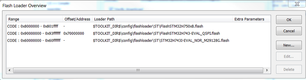

Khouloud GARSI
Hi @Community member​ ,
Using the project under EWARM IDE, could you please check the Flash loaders? You should make sure that at least the second one shown in the screenshot below is available.
I have tested the application from my side and it's working conveniently: Using EWARM, in order to load the project image from the IDE, "Project-> Download and Debug" is all what you should do.
Khouloud.
