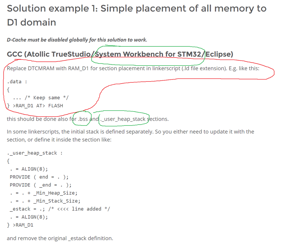

In order to overcome the DMA issue, I select solution 1 which is considered to be the simple method.
From here there are some confusing things
In cased System Workbench for STM32 - STM32 IDE
quote "Replace DTCMRAM with RAM_D1 for section placement in linkerscript (.ld file extension). E.g. like this:
.data :
... /* Keep same */
} >RAM_D1 AT> FLASH
this should be done also for .bss and ._user_heap_stack sections."

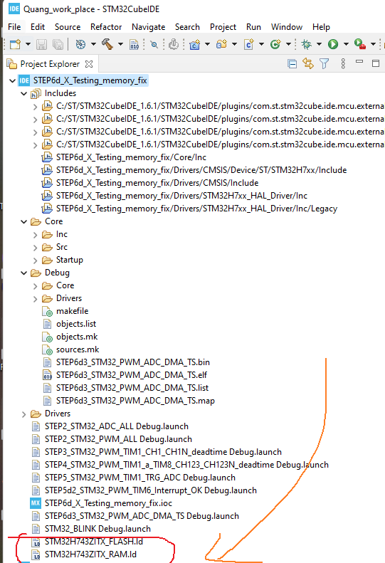

=>Question 1: there are two .id files one is flash one is Ram. -> I think that we need to change all (it depend on your programming method - store in FLASH OR RAM )
STM32H743ZITX_FLASH.id and STM32H743ZITX_RAM.ld

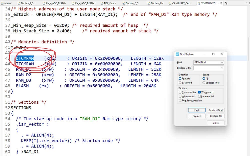

"Replace DTCMRAM with RAM_D1 " is not clear. In my case, it is hard to know which one to modify ???
For example , does it mean ? we should replace " DTCMRAM (xrw) : ORIGIN = 0x20000000, LENGTH = 128K" with " RAM_D1 (xrw) : ORIGIN = 0x20000000, LENGTH = 128K" ???

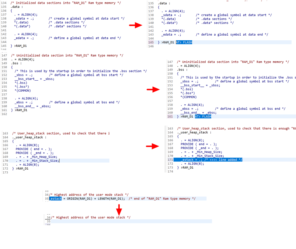

DO you mean that we should modify like this
.data :
. = ALIGN(4);
_sdata = .; /* create a global symbol at data start */
*(.data) /* .data sections */
*(.data*) /* .data* sections */
. = ALIGN(4);
_edata = .; /* define a global symbol at data end */
} >RAM_D1 AT> FLASH
.bss :
/* This is used by the startup in order to initialize the .bss section */
_sbss = .; /* define a global symbol at bss start */
__bss_start__ = _sbss;
*(.bss)
*(.bss*)
*(COMMON)
. = ALIGN(4);
_ebss = .; /* define a global symbol at bss end */
__bss_end__ = _ebss;
} >RAM_D1 AT> FLASH
._user_heap_stack :
. = ALIGN(8);
PROVIDE ( end = . );
PROVIDE ( _end = . );
. = . + _Min_Heap_Size;
. = . + _Min_Stack_Size;
_estack = .; /* <<<< line added */
. = ALIGN(8);
} >RAM_D1
Question 4:
quote : "and remove the original _estack definition."
_estack = ORIGIN(RAM_D1) + LENGTH(RAM_D1); /* end of "RAM_D1" Ram type memory */
/* <<<< line Delete ???*/
do u mean we should delete this line?

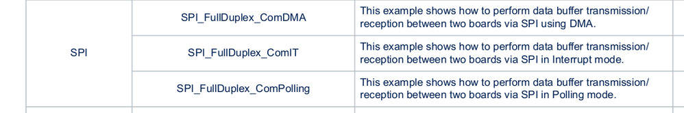

There are many examples for H7 SPI, just download stm32CubeMX.
https://www.st.com/en/embedded-software/stm32cubeh7.html
AP Note:
AN5033
Application note
STM32Cube MCU Package examples for STM32H7 Series
See:
The FLASH linker script is used by default. You should just delete the other one to avoid confusion.
=>Question 2
Don't touch what you have circled here. Follow the previous picture for what to replace, you circled it in your previous picture.
Question 3:
Delete the RAM linker script.
Question 4:
Yes.
Question 5:
Yes

2021-07-23 6:36 PM
Thank you for your answer :D
I only have one concerned about question 2 ?
In a nutshell, here's what I changed, (see the attached picture)
Please check if I'm doing it right? "Replace DTCMRAM with RAM_D1 for section placement in linkerscript (.ld file extension). "
