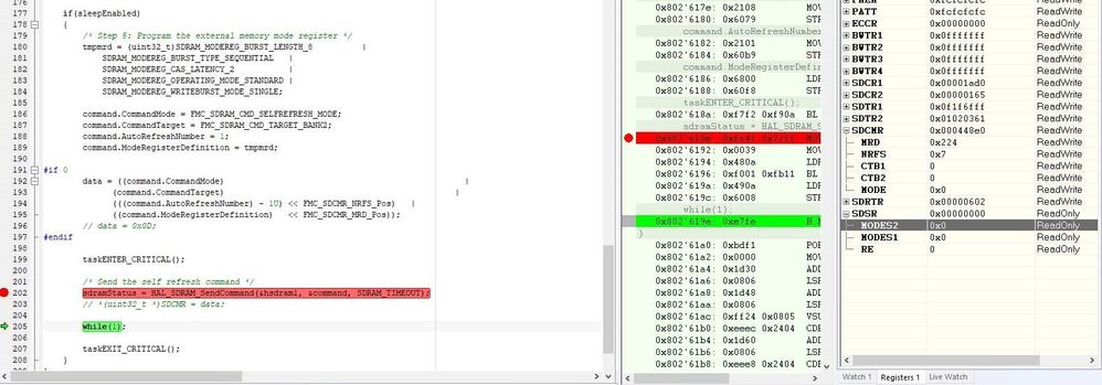

0693W000006ENLTQA4.jpgAfter the firmware is up and running, I am trying to put the SDRAM in self-refresh mode. We are using FreeRTOS. In order to put SDRAM into self-refresh mode, I write 0x4480D to FMC_SDCMR register. I am using IAR debugger, and I execute the statement HAL_SDRAM_SendCommand(&hsdram1, &command, SDRAM_TIMEOUT); manually from the debugger. This way, I assume SDRAM should be in idle state when I am issuing the self-refresh command. I am only issuing the command to bank 2 since we use only bank 2 in our design. After I write the value to FMC_SDCMR, FMC_SDSR still says it is in normal mode instead of self-refresh mode. Below is the snippet of code that I am using.
  if(sleepEnabled)
       /* Step 5: Program the external memory mode register */
       tmpmrd = (uint32_t)SDRAM_MODEREG_BURST_LENGTH_8         |
           SDRAM_MODEREG_BURST_TYPE_SEQUENTIAL  |
           SDRAM_MODEREG_CAS_LATENCY_2          |
           SDRAM_MODEREG_OPERATING_MODE_STANDARD |
           SDRAM_MODEREG_WRITEBURST_MODE_SINGLE;
        command.CommandMode = FMC_SDRAM_CMD_SELFREFRESH_MODE;
       command.CommandTarget = FMC_SDRAM_CMD_TARGET_BANK2;
       command.AutoRefreshNumber = 1;
       command.ModeRegisterDefinition = tmpmrd;
        taskENTER_CRITICAL();
        /* Send the self refresh command */
       sdramStatus = HAL_SDRAM_SendCommand(&hsdram1, &command, SDRAM_TIMEOUT);
       // *(uint32_t *)SDCMR = data;
        while(1);
        taskEXIT_CRITICAL();
