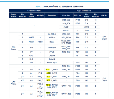

In fact, you can use all the Pins on the Arduino CN9 connector as ADC inputs:
For the Red or yellow marks next to an interface, it will show you the pin conflicts (for example here IN2 is not used since PF11 and PF12 are mapped to other functions, if you don't need them, you can just disable those two interfaces (or just remap the pins if possible) and use them for the IN2).
PS: Don't forget that on a board, you can't use all pins on the MCU. You just can use those mapped to external Connectors. Refer to the UM2679 for more details.

Using the CN9 connector reserved for analog input, I can obtain the analog data I want by determining the processor pin that this pin will map to. Did I understand correctly?
Afterward, I can show the data I have obtained as a graphic on the screen, is it correct?

Exactly, CN9 pins can be configured and use as ADC Inputs.
You can Show the Values on the Screen using some TouchGFX configurations.
