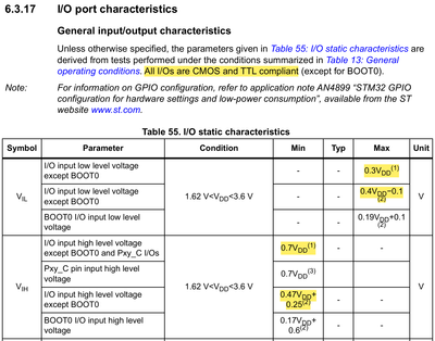

This is a digital input, so it will need to respect the digital input levels. Generally, a low of 0.3 VDD or less and a high of 0.7 VDD or more. It's unlikely a 1 Vpp signal will satisfy both of these.

As TDK said, RMII clock level should have the typical 0 .. VDD level.
