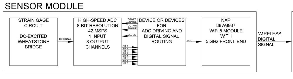

Thank you for this additional guidance. Hiring a designer unfortunately isn't in the picture, as I'm a PhD student working on this concept for my research. Also, I'm working in material science/engineering and most of my electrical experience so far is limited to our DC strain gauge circuits. For most of our work, we let Tektronix devices handle our signal conditioning, which requires a time domain resolution in the 100 ns range. If I can sort out triggering, I can run it in a short burst of 40 MSPS, but the "easier" option would be to just run continuously.
The SDIO portion of the system is the fastest option for data input and control in the wireless module I'm looking at (NXP 88W8987). I had thought it would be convenient to package the data before transmitting, but perhaps that step just slows the process down. The other option then would be to use the processor on the receiver end to receive the raw signal and package it as it comes in. So I guess writing isn't exactly necessary within the sensor device, as long as it can be transmitted out to be written by the processor on the receiver end. I've included a basic diagram below of what I'm trying to accomplish on the sensor/transmitter end. The unknown at this point is the stages between the ADC and the wireless module.
