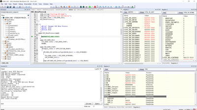

I had made a simple test on H745 disco board and I can see the timer counter is triggered as expected.
