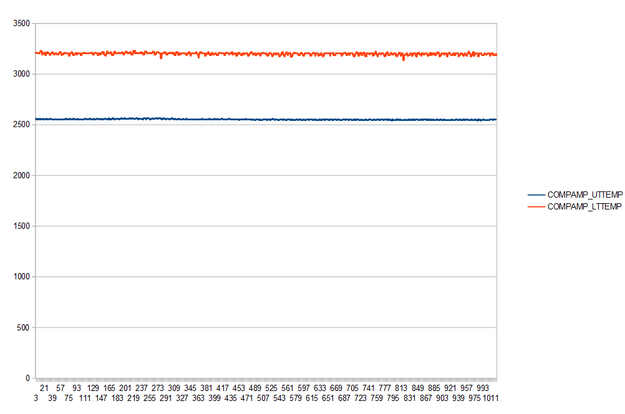

The problem we face is that the channel IN12 (PC2) seems to have a different transfer function as the rest of channels.
We have applied the same voltage to IN12 (PC2) and IN1 (PC3_C) and we get different binary values.
Here 1024 samples are shown , COMPAMP_UTTEMP (IN12) and COMPAMP_LTTEMP (IN1).
Since IN12 (PC2) is connected internal to all 3 ADC,
we did the same test with PC2 connected to ADC2_IN12 (ADC2 configured as 12 bits) with the same result.
we did the same test with PC2 connected to ADC1_IN12 (ADC1 configured as 12 bits) with the same result.
The Voltage measured with a multimeter at MCU pins PC2 and PC3_C is identical, nevertheless we get the ADC data shown in the previous graph.
The ADC3 calibration is done during boot process.
Can you give us a hint/explanation why IN12 behave different on all 3 ADC?

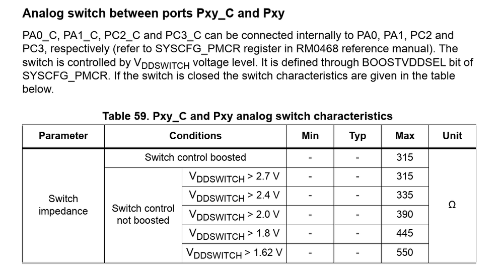

these xx_C pins are not "normal" pins, they are connected via an alalog switch :
and from ds also:
(I dont use this xxx pins, if possible.)
In your measured data you can see: the blue from PC2 is much more clean than the data from PC3_C ;
read in rm , how to connect the xx_C pins - if you really need to use them.
And care for higher resistance with this analog mux, needs more sampling time (slower sampling).

in the trace we uploaded, PC3_C is giving the right binary value. The wrong channel is INP12 connected PC2. And it is wrong when configured for ADC1, ADC2 and ADC3.
We keep the switch you mention OPEN (Not connected) as shown in the code in our first post.
We did read the manual and tried different sampling frequencies with different source impendaces for the ADC driver.
The result is always the same:
