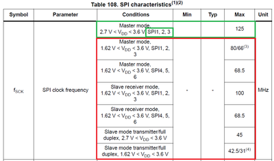

You are absolutely sure you're using a 125 MHz capable peripheral?
I mean: which SPI block x?
And which H7 exactly?
Here's from the H723 datasheet, and the maximum clock depends on supply voltage and which SPI block (1..6) is used:
PS: using a 100 MHz scope for a 125 MHz signal is not really optimal... but you should see at least something (closer to a sine).
