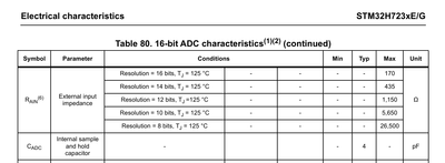

2025-11-18 4:32 AM

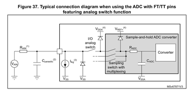

These are listed in the datasheet.
RAIN and CADC form a low-pass filter as described:

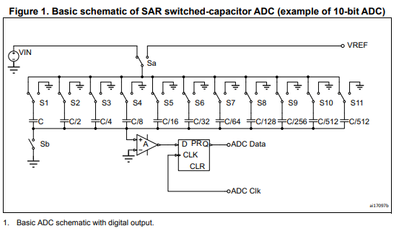

Thanks for sharing that. I was going through AN2834, where a little detailed internal circuit of ADC is shared:
that lead me to query the datasheet specs. So is the CADC equivalent of all these capacitors or just the C. And what about tracking bandwidth?

Capacitance 5 pF total.
Bandwidth is defined by first order LPF: Fbw = 1/ 2 x PI() x Rin x Cin
