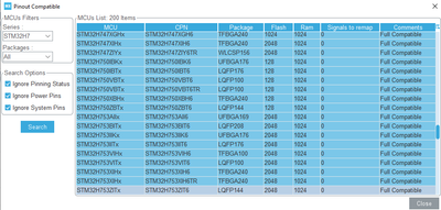

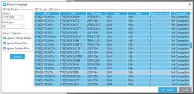

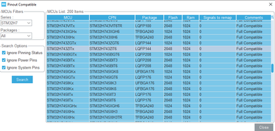

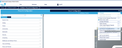

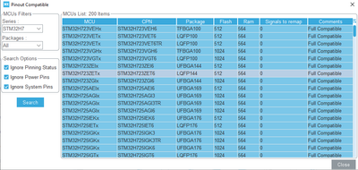

You can check the compatibility pin by using the STM32CubeMX. This toolchain allows you to know the list of MCUs with Pinout compatible, you just need to start by creating a new project using your STM32H723ZGT6 and press Pinout to get the list of all compatible MCUs as presented in the below figures:
