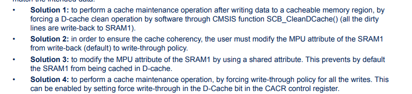

You need to apply the cache maintenance when you enable the D-cache when using another master DMA/SDMMC/ CM4 (in dual core). You can disable the cache for the shared memory between the CM7 and the other master using the MPU (MPU policy: Device) but that decreases the performance.
Please refer to the application note AN4839 "Level 1 cache on STM32F7 Series and STM32H7 Series" / especially the section 3.2 Example for cache maintenance and data coherency.
The different available solutions:
Hope that answers your question.

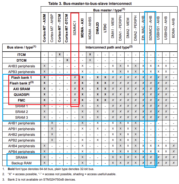

OK. And what is the region of RAM used by sdMMC ? The MCU is one core ,. just need to stop caching in this region. As I see sdMMC used MDMA. But where is allocated RAM?
2026-02-25 7:06 AM
Please read the documentation especially the user manual of the product. From RM0433:
The memories accessible by SDMMC1 and SDMMC2:
The RAM used by the SDMMC depends on the user configuration in his application.
