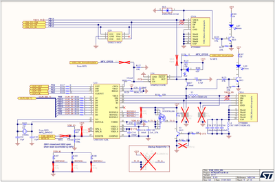

Hi @AC3
Check schematics, as long as there are no external PHY to cover high speed operations on H745 Nucleo board, it is impossible to get it working in HS.
For your custom board, you can refer to this schematics sheet 9 to develop your HS USB application.

2025-04-08 5:42 AM
Hi @AC3
