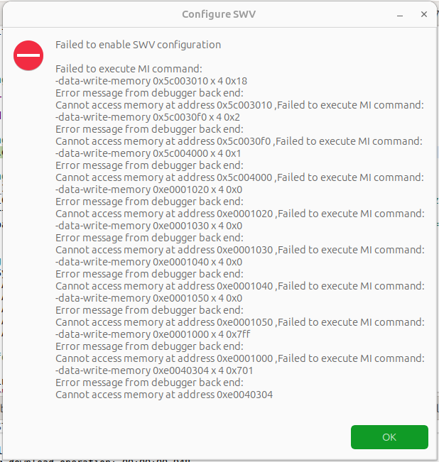

Hi, did you get a solution to this? I'm having the same problem.
SWV works perfectly with HSI and HSE directly, but not through the PLL. Trying to start the Trace errors out with the following error.

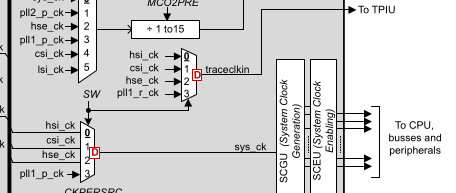

I found that I was disabling PLL1's R output and it is the input clock for the TPIU, from the datasheet:
Enabling this fixed the "Failed to enable SWV configuration" error.

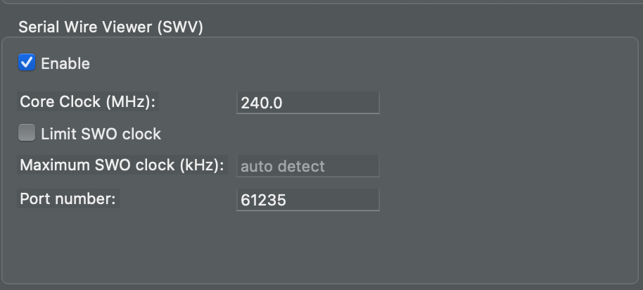

In the Debug Configuration, I've found that setting the Core Clock of the SWV config to the PLL output is what works when PLL1P and PLL1R are equal. When PLL1Rclk < PLL1Pclk, the Core Clock configuration in the IDE should equal the D1 domain clock used by the core.
I believe on other STM32 mcus (F & L series), the IDE's SWV core clock should equal the AHB clock.

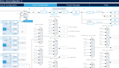

Working clock config as below:
After editing the Debugger config in CubeIDE to enable SWV and setting the CPU clock speed there (alongside SWV settings) to 400 MHz, I found that printf() produces no output and variables added to the SWV Data Trace Timeline Graphs are NOT logged.
After lots of experiments I found that if I set the CPU clock in the debugger settings for SWV to 64 MHz, then I see some garbled data coming out printf() on the SWV ITM Data Console view, and occasionally some invalid data variable trace values - clearly there's something wrong in that setup.
When I changed my core clock in MX to 200 MHz I noticed a warning from MX that the PLL1R clock was too high at 400 MHz, so I changed its divisor so that PLL1R clock is 200 MHz, then with the Cube IDE debugger config now set to 64 MHz core clock setting I have printf and data trace logging working perfectly. This is strange because standard advice is that SWV's configured CPU freq is supposed to match the true CPU clock.
I then changed my core clock in MX back to 400 MHz, and despite there being no warning this time that the PLL1R clock was too high, I used the modified divisor setting to ensure that it was again 200 MHz. With that configured, and the CM7 CPU at 400 MHz, along with my debugger settings set to 64 MHz core clock, I have SWV working perfectly. Once again, that shouldn't be the case, but it works so I'm going with it until somebody gives me another solution.

You can have PLL1R different from SYSCLK but the Core Clock settings must be the PLL1R value
My SYSCKL is 480 MHz and my PLL1R is 240 MHz
