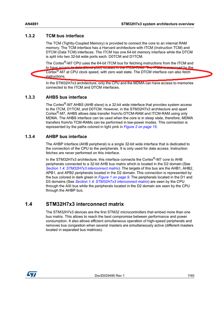

But it seems to work, with cache disabled.
I tried to change the link script: ITCM RAM for code and DTCM for data. This of course works.
So, is DTCRAM good for code or it works by coincidence and not supported officially?

2019-09-03 3:48 AM
2019-09-03 3:28 PM
