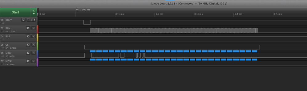

I checked with logic analyser and it is working fine :

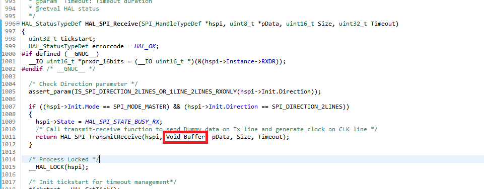

Fixed by modifing HAL lib with this : Void_Buffer is a buffer I fill with 0 at init

When I switch from Half-Duplex to Full-Duplex the reading works but I want to use Half duplex since Full is making my slave crash / reset. I think my slave is bugging because the HAL SPI lib echoes the message. Is there any simple way to "mute" MOSI, it is very annoying that Full Duplex HAL lib can't work without transmitting data. Calling the Transmit_Receive function that needs a Tx ptr to work :face_with_tears_of_joy: .
2021-01-20 4:10 AM
2021-01-20 7:01 AM
You can de-initialize the MOSI pin if you don't want a signal on it.
By setting the buffer to zeros, you're still sending data.
2021-01-21 2:43 AM
@TDK Just to be sure, when you mean de-initialize, I set MOSI as analog in ?
About the buffer, I am technically still sending data but only zeros means the line stays at low level
