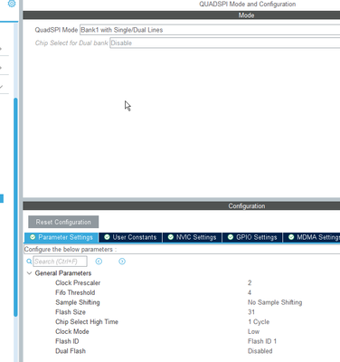

2024-04-04 8:19 AM - edited 2024-04-04 8:23 AM
In main the two functions HAL_QSPI_Command(....) are working, I see clock and output data with oscilloscope, the
HAL_QSPI_Trasmit_IT (...) is made but I don't see the data and clock in output. My goal is to use only the HAL_QSPI_Trasmit_IT (...) for send 4byte to external DAC.

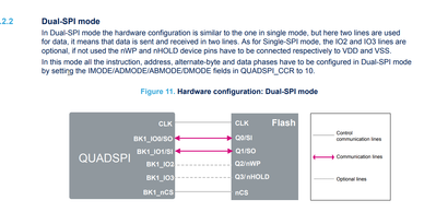

The datasheet provides the SPI mode for QSPI, but I can't find any examples of using it in this way.
In my card I have only QSPI available the other SPIs are already occupied.
I wanted to avoid writing the driver;).....I was wondering if anyone has already been there or if there are documented examples.
On a hardware level, it seems possible:
