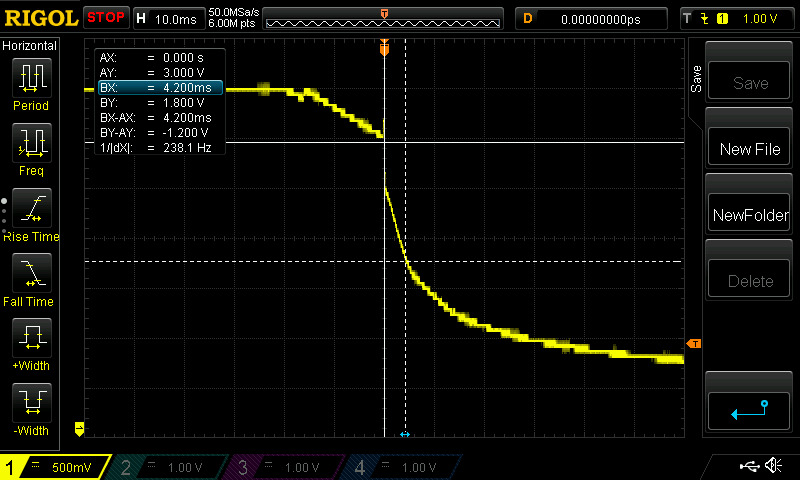

VDD and VDDA are on the same power bus, and it takes approximately 4.2ms to drop from 3V to 1.8V (I'm running 160Mhz clock, so 4ms should be enough to move a GPIO).

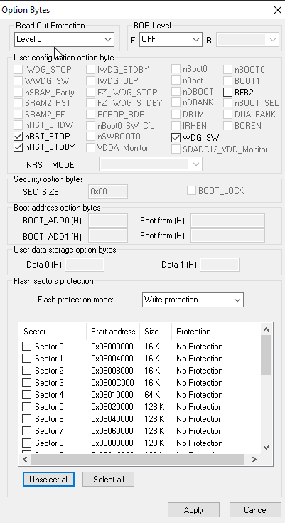

Do you use Brownout Detection (i.e. what's the value of FLASH_OPTCR.BOR_LEV)?

3) Brownout is disabled
