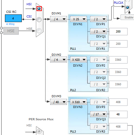

2018-04-26 5:47 AM
PS: I checked the particular case for PLL3Q used as clock source for USB and I don't see a message for DIVQ3. You need just to put correct values to get the 48MHz output for USB.
I am using CubeMX 4.25 and following configuration gives me the 48MHz output on PLL3Q:
-Amel
