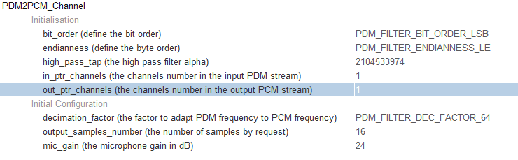

}I am using the STM32CubeIde to initialize it and everything, so all of that is there. I have it set to 1 channel input and output since I am testing only one mic at the moment.

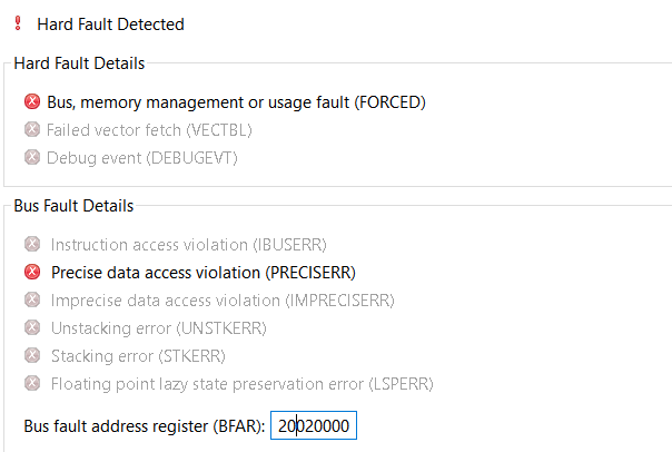

So when I run the code, it get a hard fault when I enter the PDM_Filter function. It gives me a hard fault.
I've tried changing the buffers, pcm/pdm arrays size. I also tried changing them to int16_t and uin16_t. I've looked at other examples. The library seems pretty simple to use, but I'm just stuck on what could be wrong. Are there any verified examples?

Seems like you are overrunning the bounds of an array. 0x20020000 is the end of the DTCM, which is where pdmData/pcmData probably exist. How many samples are you processing in each call.
2021-05-06 2:45 PM

It should only be processing a byte of PDM information and outputting a 16-bit PCM signal at a time, unless I am misreading the application's note.
2021-05-06 4:17 PM
Wait, when I change the output_samples_number it started working. I thought that number was asking for how many bits you wanted the outputted number. Like a 16-bit PCM value. What exactly is 16 samples? Is it just 16 values of the same PCM number?
