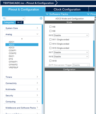

2024-05-14 8:31 AM
Thank you very much for your response.
The version of the IDE: STMicroelectronics STM32CubeIDE 1.15.1
The version of the CubeMX: 6.11.1-RC2
The chip I working on is: STM32H723ZG
FW HW: STM32Cube FW_H7 V1.11.2
You can (hopefully) reproduce the issue by:
1) File -> New -> STM32 Project
2) Choose the MCU: STM32H723ZGT6
3) Finish the configuration of the project. Accept the default configuration.
Now we can see that ADC2 IN16 is missing.

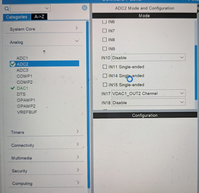

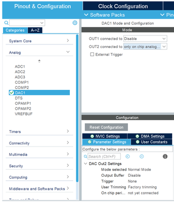

4) Set up the DAC1_OUT2 to peripherals:
5) Setting the ADC2 IN17 leading to infinite loading:
Saving the ioc file now break the application as you cannot do anything anymore.

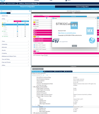

2024-07-29 4:16 PM
In CubeMX 6.12.0 for STM32H755BITx, I can not select DAC1_OUT2 to be monitored by ADC IN17. IN17 is not available for section - CubeMX skips from IN16 to IN18.
