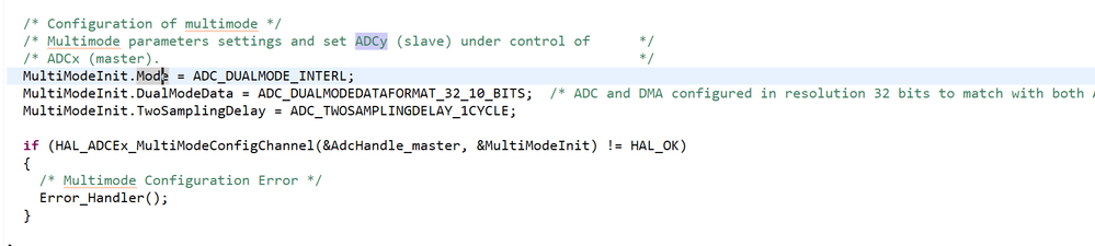

The main difference I see between this code and the STM32 F7 is this part:
And then the multimode:
How are we able to set this up on an .ioc file?
In specific how is possible to set ADC master triggering the ADC slave conversions?

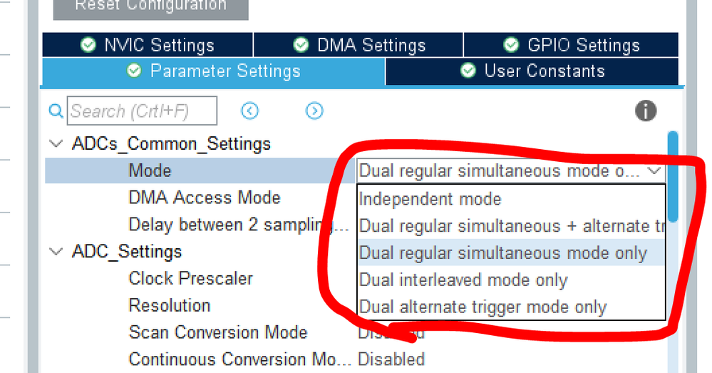

You should be a little more specific in your needs. Specific chip, specific ADC setup (interleaved vs independent).
Yes, you can configure two ADCs in dual mode in IOC using the "Mode" option.

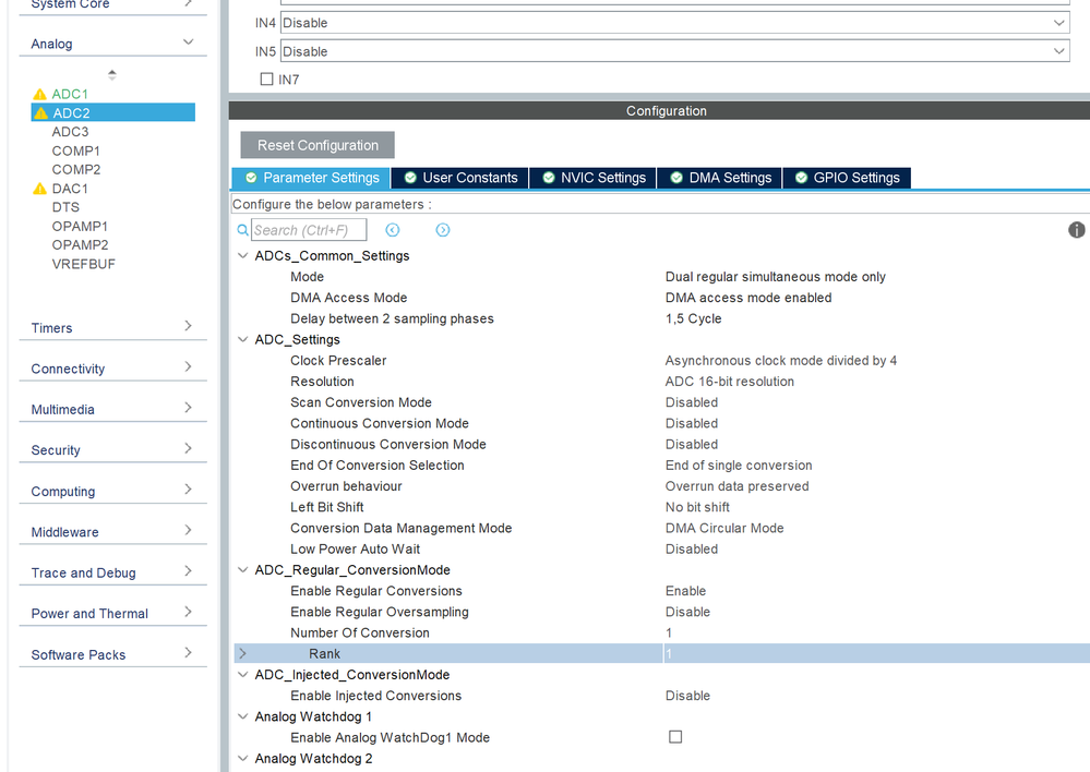

we are using STM32H723VGT6 and we have tested many times using "Dual regular simultaneous mode only", the issue is if we do that the DMA interrupt is not triggered.
Has anybody tested this setup using IOC? Maybe it is a bug of the tool itself.

For example, @TDK , to clarify things this is what happens when you set Dual Regural simultaneous mode on the ioc file.

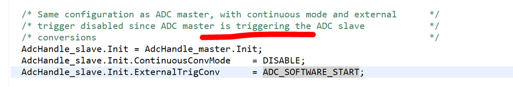

The ADC Slave cannot be setup in ADC_Software_trigger mode, as in the example you provided.
I am not so sure about this setup will work using ioc:

2022-04-21 6:00 AM

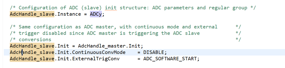

I don't have a ready made example for you. I imagine it's possible within an IOC. I would look at the ADC registers to try and determine the difference between what you want and what you're getting and use that information to guide what you change within the IOC file. I believe ADC_SOFTWARE_START is the correct selection for that field for the slave, as that's what is done in the dual mode CubeH7 example suggested above.
2022-04-21 9:18 AM
Thank you TDK.
The problem is that to set ADC_SOFTWARE_START you cannot select Dual Mode in the ADC2 with ioc.
