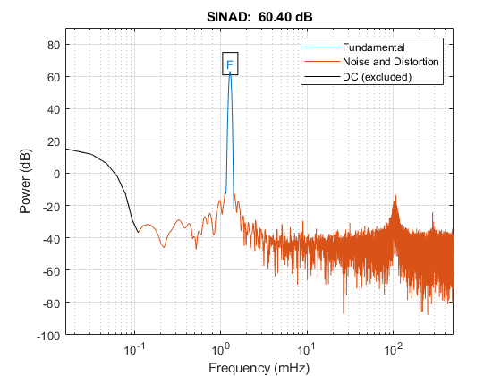

I am currently trying to get the ADC on the STM32H745ZIQ to work like it should according to the AN *Getting started with the STM32H7 Series MCU 16-bit ADC - Application note.
On page 3 the spectrum is shown along with the measurement settings.
I tried to replicate that spectrum but I'm stuck.
To my measurement setup:
I would expect the SINAD to ideally to be around 12*6.02+1,76 = 74 dB.
I'm aware that this will obviously not be the case as the ENOB is always lower than the specified accuracy.
Nontheless I stagnate at around 60dB with some weird noise floor.
I also tried to reduce noise by using hardware oversampling but that seems to increase the phase noise, which is just as bad for my application.
The last few days I played around with different Settings, looked into issues like pin crosstalk, power supply noise, noisy input signals and low-pass filtered the input.
Below, I will post some code and the resulting SINAD.
Thank you in advance for any ideas that you have that might help me reach the accuracy that is promised on the DS.

2022-08-29 7:51 AM
btw the diagram is in mHz , milli-herz , ok so ??? or should be : MHz , but then it goes up to 1 GHz, i would not trust any of this... :)
i would try
first: increase sampling time of 1.5 Cycles to 6.5 or so;
next : test inputs to GND, no cables connected -> what abaut noise and spurs now ?
and 16 bit resolution of adc, you gain nothing by cutting away lower bits.
and maybe a FFT, that looks more realistic from frequ. range :)
2022-08-29 8:38 AM
I'd say, not bad. Check data sheet for your uCPU, ADC specification section. Usually, noise-error a few LSB, so counting to get 12-bits theoretical limits is a mistake. 60 dB roughly 10-bits, pretty good result for internal ADC. 100 MHz noise may comes from other peripheral like Ethernet, I had similar issue with nucleo-H743zi, where I had to cut power for Ethernet completely.
Phase noise indicates for bad clock, what is a initial source for PLL - HSI? For low jitter crystal is a must.
What about Reference voltage for ADC? Is it the same as V-analog?
What kind of ADC driver OPA? Is it capable to interface SAR ADC - there are not many good quality OPA on a market, 74 dB at 1 MHz - is very tough requirements.

Thank you for the response.
I have the same suspicion regarding that noise. I used the same measurement setup for other ADCs and/or channels on the board and every adc had this characteristic noise spike.
Yes, currently the PLL source is HSI. Do you recommend using HSE or LSE with a Crystal/Ceramic resonator instead?
Yes, basically I power the board via USB. I understand that noise coming from the power supply directly influences the measurements because Vref is derived from it. Sadly however, I don't have access to a sufficiently noise-free DC power supply.
The measurement results for 16-bit from the AN also show a deviation from ideal SINAD of around 14dB. It could be that 60dB is just the limit for 12-bit for this eval board. Nontheless if any improvement is possible, i would like to try it still.

On a web page, you can download CAD resources, circuits & BOM as well, it shows a crystall at HSE inputs. For Nucleo, there is also an option to get clean clock source out of STLink (8.33 MHz). Check ST web resources on this matter, a lot of discussion/ advises posted on this board.
My mistake, test freq. 2 kHz - not 1 MHz as I think, still question persist how SG - Input RC filter & driver build, please post connection diagram /circuits or at least picture of the test setup
